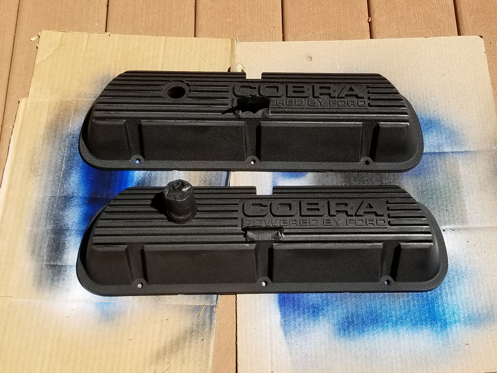

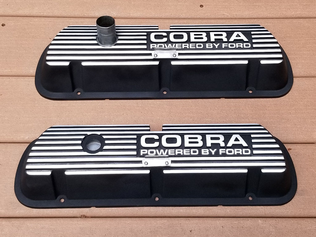

Thanks Denny, here they are finished...
VERY NICE!
Thanks guys!

Hi Dave,
Nice work.  Care to share your recipe?  Did you mask the fins or just removed the paint before putting in the 110 Degrees F  ?  How did you remove?  I can see you masked off the tube and plug wire brackets, but not the fins.  Or am I  blind?
Thanks
Cory
Thanks Cory. I did not mask the fins or letters, no need to call Hovander for an eye exam. I just lightly wiped the fins and letters with WD-40 to prevent the paint from sticking well and sprayed directly in the 110F heat, paint started to krinkle very quickly. There were some small scratches that I wanted to clean up anyway so removed the fin/letter paint starting with 180 grit sandpaper followed by 400 grit. IMO the WD-40 definitely helped the paint come off easier.

400 grit is too fine compared to originals and NOS IMO.  250 grit would be the most to go if you want a factory finish. It all depends on if you want a personalized look or a factory look.
Thanks Bob, I was wondering about that. I'll get some 250 and "rough it up".

I like the sharp transition between the paint and the sanded letters and fins. However, it looks like the crinkle finish is more a sandy, granular finish. Might the WD-40 have contaminated the crinkle agent?

 The wrinkle texture is effected by the amount of paint in a given coat , number of coats, direction paint is applied (at least three directions at right angle ) and heat. Silicone contamination could effect a local area but typically not consistently on the overall surface.

I don't think the WD-40 had any effect on any of the surrounding surfaces. The paint definitely has a nice wrinkle, just didn't show up well in the posted photos. While I was very pleased with how these turned out for my purposes, they are not perfect, mainly due to some inconsistencies, especially between the fins/letters where I didn't get the paint evenly thick enough. Bob hit the nail on the head, crinkle quality is very sensitive to all the things he mentioned. It was very tricky to get the coat thickness really even, especially given this was a quicky project painting on a flat surface, I was surprised how well they did turn out.  I think if I was going after the best possible finish I would have them powder-coated.

I wouldn't sweat it. Many/Most  NOS and assemblyline originals were not perfect in every way when new back in the day.
6s341
They look great to me, nice job, and thanks for sharing the techniques!
