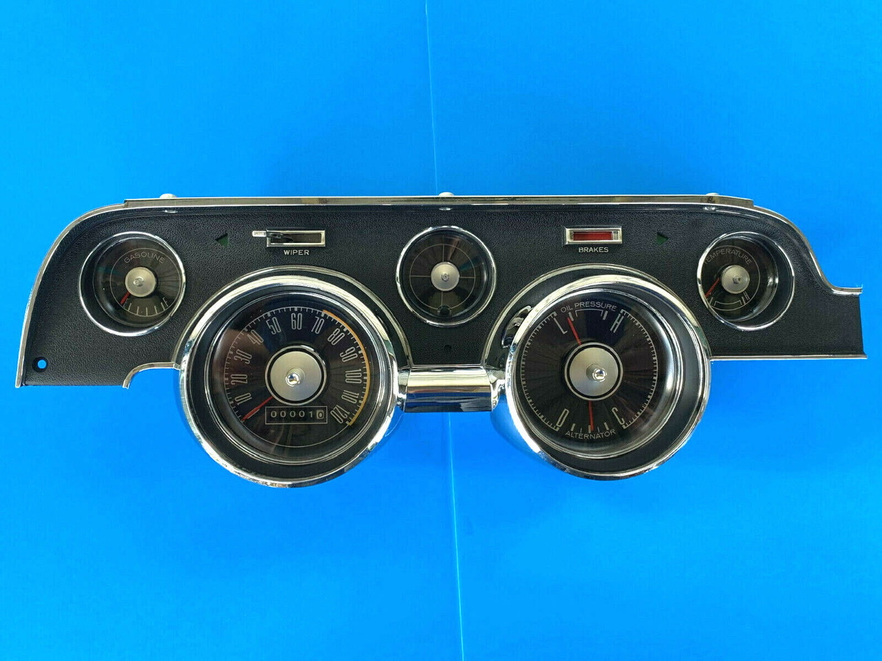

My customer and I are guessing which instrument is correct for his S Code I say
120 mph without trip odometer
6000 rpm
oil pressure in the middle, left gas tank, right Amperemeter
at the moment he has not the correct instrument in the car and I would like to bring it back to original. Thanks for the help
From other examples
Top row (left to right)   Fuel  - nothing but a black face place holder (gauge/clock if ordered) - Water Temp
Large gauges (left  to right) 120 MPH Speedometer  - 6K Tach
Oil pressure light integrated in the tach at the bottom

Picture from eBay

Believe it was "automatic" with a 4 speed. Other examples with it not listed on the Marti report had tachs in my sampling. Could not find an example (s code 4 speed) without one.
Would mention that this is fairly common for 4 speed big blocks. The 69 big block 4 speeds I've owned didn't have tachs on their Marti though each had them (unrestored cars)

I believe also as I had many S Code´s from 67/68 with 4 speed that the 6k tach always and automatic was without as it was not needed. any other ideas or opinions? Thanks for the great help

My 67 S code is a factory four-speed non-GT car. It came equipped with a 6K tach. Years ago I had a 68 S code factory four-speed non-GT car. That one was factory equipped with a 8K tach.

If your thinking of asking Kevin if he does not include items that are part of a package or comes automatically with a certain set of options I feel confident that he will confirm. Believe this is a path we have visited at least ones (with the S code tach question for 67) before
Believe I do have copies of cars with both Marti reports and buildsheets confirming tachs but not sure that those documents will sway others  :)
