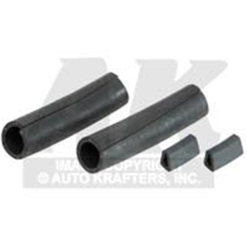

That begs the question what is this rubber insulator? Does anyone have pictures?

Im not going to say it is heater hose, but it's awfully similar
It is not heater hose however that will work but the hose off of the upper 67/68 fastback vent boxes is a pretty exact match in thickness , outside diameter and ribs on exterior.

Should I have these insulator pieces on my February 1968 gt350?  I presume they go on the top where the bracket passes thru the fiberglass valance?
Are these sold by anyone?

Yes.  The major suppliers have them.  Or, go through salvage cars.

What are those square rubber pads for?  Would they be used on a Shelby or just a Mustang?
Are the set NPD sells very good?  The CJ Pony Parts ones are clearly just pieces of coolant hose so just wondering if NPDs are the same.

Yes pads serve the same contact protection as hose . Unlike the repro hose the pads look correct.
Also unlike the hose which you can find still on many donor cars the pads came off easy and are seldom found still on .

Thank you all for the very helpful comments and illustrations.  I was able to source some originals from West Coast Classic Cougars.  I also purchased the set off NPT so I have the square pads as well.
