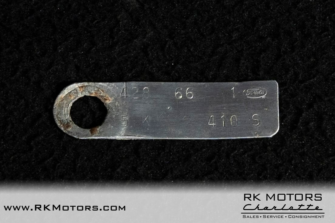

Let's talk about this metal tag from the RK Motors listing for 67400F2A01983.
A 1966 model year 410 numerical id 428 engine dated October 1965.

430dragpack
Quote from: 67_1183 on March 06, 2021, 05:30:27 PM
This thread has went stale.
Link to listing:
https://www.ebay.com/itm/1967-Ford-Shelby-Mustang-GT500/224373086574?hash=item343dad996e:g:daIAAOSw691gQDi1&vxp=mtr
Nothing really to discuss, clearly not the correct metal engine ID tag for a 1967 GT 500, but rather a 1966 Galaxie more than likely.
