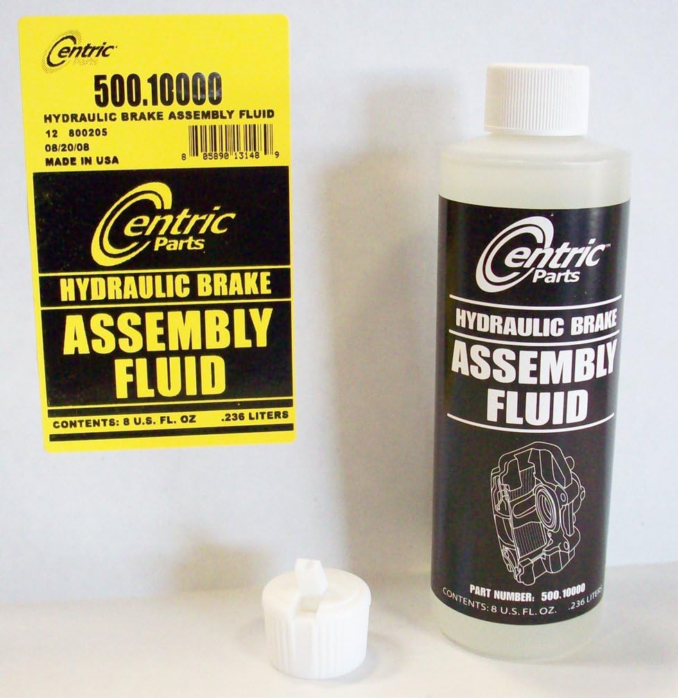

I never use brake fluid to assemble hydraulic parts. Here's why:

Quote from: Bossbill on May 08, 2020, 03:50:09 PM
You can also ask the people who rebuild them and warrenty them if they fail use. FYI if you have a wheel cylinder ,proportioning valve etc built at white post they will not assemble them with silicone. I have to disassemble ,clean and reassemble with silicone which is what I suggest for limited driving pleasure driven cars. At least it reassembles much easier once it is has been rebuilt . What a pain. ::)
Thanks Bill, never even knew that stuff existed! Found one source that said the Centric fluid is "Compatible with all DOT 3 and DOT 4 brake fluids".

Bossbill
Quote from: s2ms on May 08, 2020, 06:19:00 PM
Dave -- The stuff I have is from another vendor (Bendix?) but it's the same idea.
