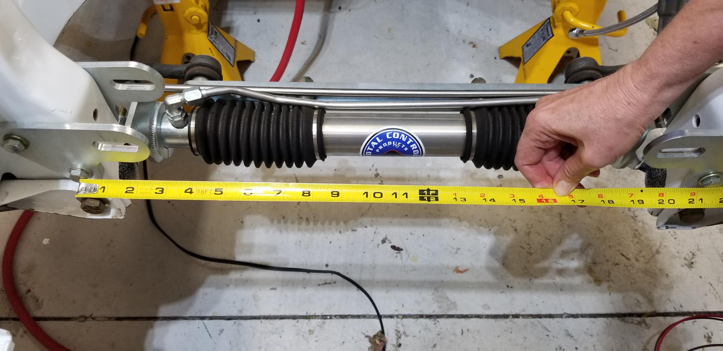

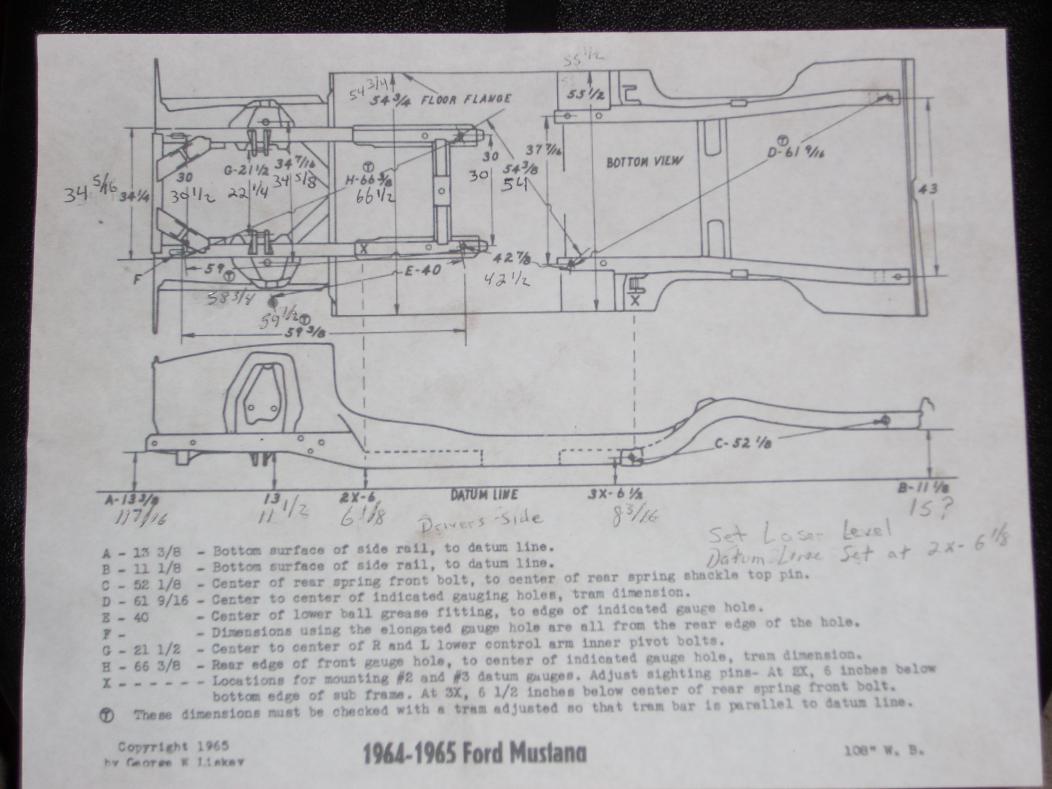

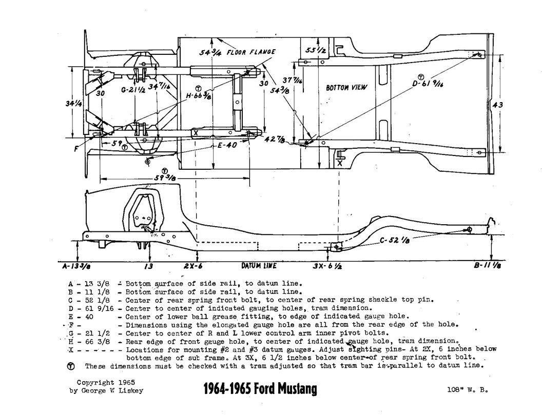

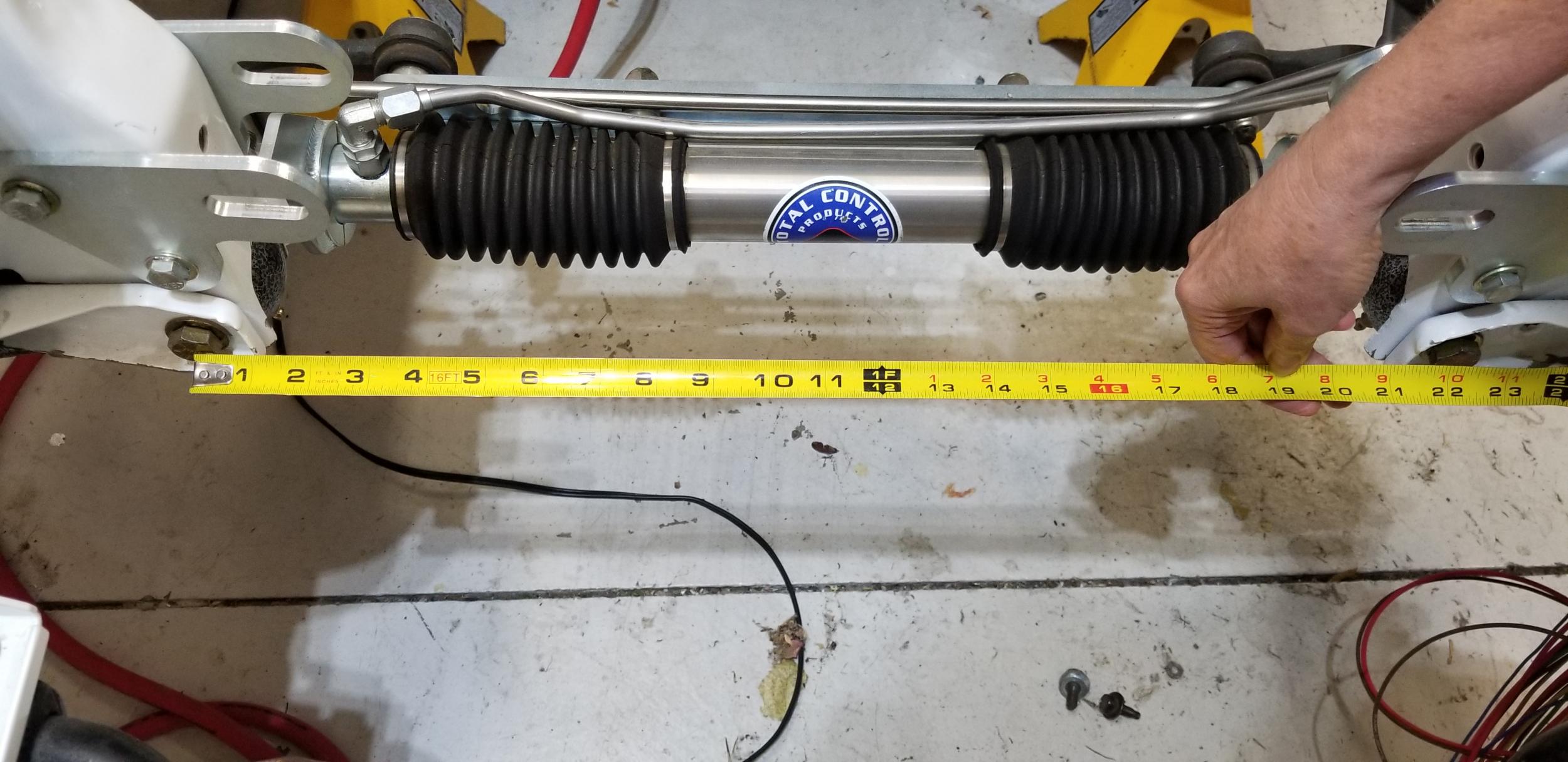

It seems that the "George W. Liskey" frame dimension drawing is the usual reference for '65/'66 Mustangs, but I believe this document has some issues. This was the reference drawing at 2 frame shops that I've used over the years. If there's a better '65/'66 frame dimension reference, I would appreciate it if anyone would let us know.
In 1992, my frame was straightened in accordance with the Liskey dimensions. The OEM Ford engine components fit OK.
In 2016, I discovered I could not install a TCP steering rack or a set of Stan's Tri-Y headers because the engine bay was too narrow. I took the car to be re-examined by another frame shop. Like the first frame shop, this second shop also had the Liskey drawing in their "Big Book 'O Dimensions" for the '65/'66 Mustangs. They confirmed that my frame dimensions match the Liskey drawing. However, the shop owner said he could tell visually that the frame was not straight. I allowed him to straighten the frame again until he was satisfied (using his experience) that it was true.
After this adjustment, my new steering-rack and headers fit fine.
A few weeks later, out of curiosity, I enlisted the help of some friends from my local Mustang Club to let me measure this "G" dimension on the frames of their unmolested '65/'66 cars. Here's what we found:
66 GT-350: 22 3/8"
66 Coupe: 22 5/16"
66 Coupe: 22 5/16"
65 Fastback: 21 1/2" (my car before 2016 straightening)
65 Fastback: 22 1/4" (my car after 2016 straightening)
The Liskey drawing note for Dimension G says:
"G – 21 ½  - Center to center of R and L lower control arm inner pivot points"
So, this dimension appears to be incorrect. However, I noticed that my car's current dimension between the two lower engine-mount holes is precisely 21 ½". This suggests another possibility: perhaps Mr. Liskey had the dimension correct, but he attributed it to the wrong location. Perhaps the note should say:
"G – 21 ½  - Center to center of R and L lower engine-mount points"
I realize this is a small sample size, but it did mitigate my problem. Just thought I'd throw this out there in case others have a similar issue.
66 GT-350: 22 3/8"
66 Coupe: 22 5/16"
66 Coupe: 22 5/16"
One more thing: I've found forum reports that other parts of the Liskey drawing, specifically those at the back of the car are also incorrect. I have no data to properly assess these reports.
