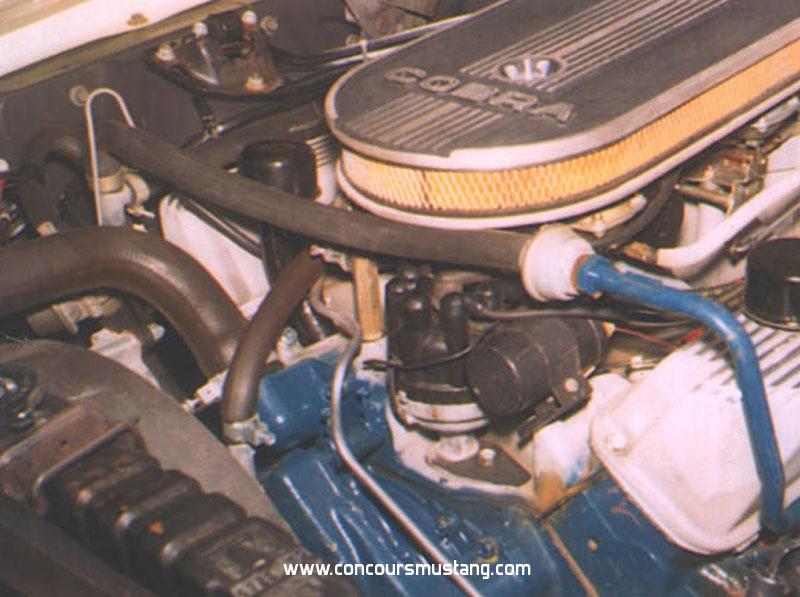

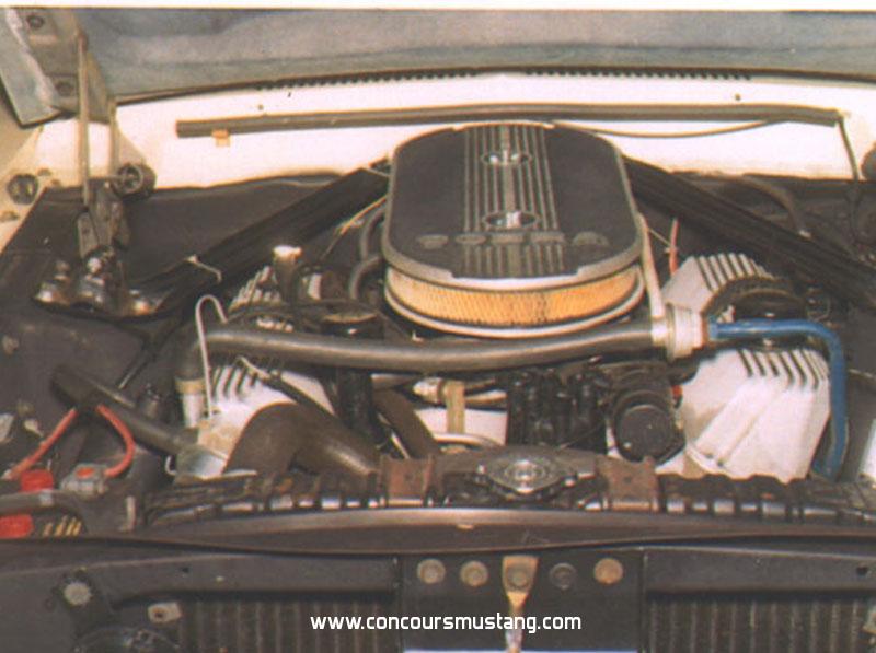

Couple of pictures from 67-962 as requested

Not so obvious because I have seen a number of the thermactor GT500's with the tall painted black caps . Typically if the valve cover cap was black so was the oil fill cap. Just another example of how complicated a subject this is. People for the most part are not trying to keep information from you and others but more like as soon as you come up with a ruling on some these parts a anomaly shows up to challenge the consciences. There are a lot of different facets to the 67 GT500 smog system. The closed emissions short  "cookie cutter" cap is what the system was engineered to get but that may not have happened because of supply problems at the engine plant. There were not many smog engines produced in 67 relatively speaking.  Strangely the oil fill cap should be a closed emission style also for the system to be totally closed off but that is not what I have seen on an unmolested cars. I feel the picture of #962 taken in the summer of 1967 is unmolested.
2112
Well, I did think that I read the closed "cookie cutter" cap was correct for Thermactor cars,
But comment was an attempt at sarcasm.   ::)
I thought I would comment that the rounded top intake fill cap in the picture is just on of several different varieties that could have come on a 67 GT500 thermactor car . In the picture of 962 for example the rounded top cap also has 'oil' embossed in the top.
2112
In the pictures of 962 above, is the canister free floating or was it hard mounted at an angle?
Quote from: 2112 on April 01, 2018, 12:19:09 AM
It is not hard mounted at a angle. With that said it could be that it came out of the band clamp because it looks a little different than the ones that are free floating. It is hard to say from the angle .

This is part of those twists and turns associated with the subject.  Cars with thermactor with similar (read close to in number) Shelby VIN to this car are from a different order group. Looking at other cars from the same order group that I have pictures and such from have the mount attached to the shock tower which would strongly IMHO suggest that 67-962 also had the shock tower attaching point for the filter canister
The angle that the canister is sitting at in the picture is a bit odd but its interesting that it appears that someone took some electrical tape and tapped the hose to the positive battery cable possibly to keep something from rattling. Of course it appears that this would do little, since the cable itself is flexible, but someone was trying to correct or fix something and not IMHO something done at San Jose nor something seen on any other Shelby I've seen.  Maybe an owner or dealer thing
