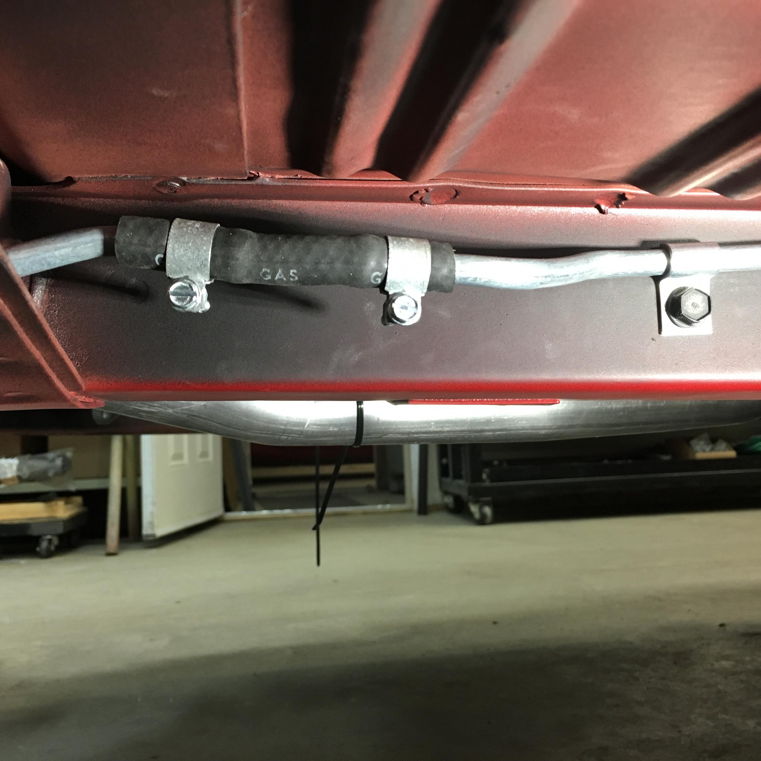

With the refresh of my undercarriage I am replacing the fuel line and I have two questions.
1) I received my new fuel lines from Classic Tube yesterday and there seems to be a difference between the new and old tubes.  With my old tubes there was a rubber fuel line that ran completely thru the drivers side torque box to join the tube from the tank to the tube that goes thru the apron.  The new tube seems to be long enough that the tubing runs thru the torque box and there would just be a very short rubber hose connecting the two tubes.  I am assuming the rubber hose thru the torque box is incorrect.  Can anyone confirm what is correct?
2) I want to confirm what hose clamps are used for every joint between the tank and the carburetor.  I am assuming the olive drab spring clamps are used everywhere but have seen mention of pinch clamps being used in some of the locations.  Can anyone clarify for me?
Thank you,  Corey
Clamps were painted silver
You are correct the hose should be very short
The factory clamps that were olive drab were for 67 and for 5/16 fuel line. The silver clamps are for 68 and up 3/8 line.
Corey Bowcutt
Thank you all.  So no pinch clamps were used is that correct?
TLea
Lot of variables here.  When was car built?  Spring clamps used at gas tank, mid section and hose to fuel pump  except through about Feb 68 #2 whiteks used and mid section. At carburetor keystone clamps if factory carb install. Shelby install and dealer install carbs likely spring clamps but if dealer could be anything
TLea
Hose section at gas tank and mid point should be 4"

Jan '68 with 3/8" hose
