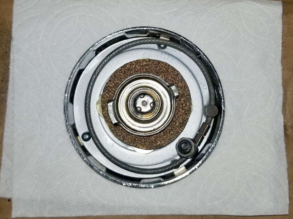

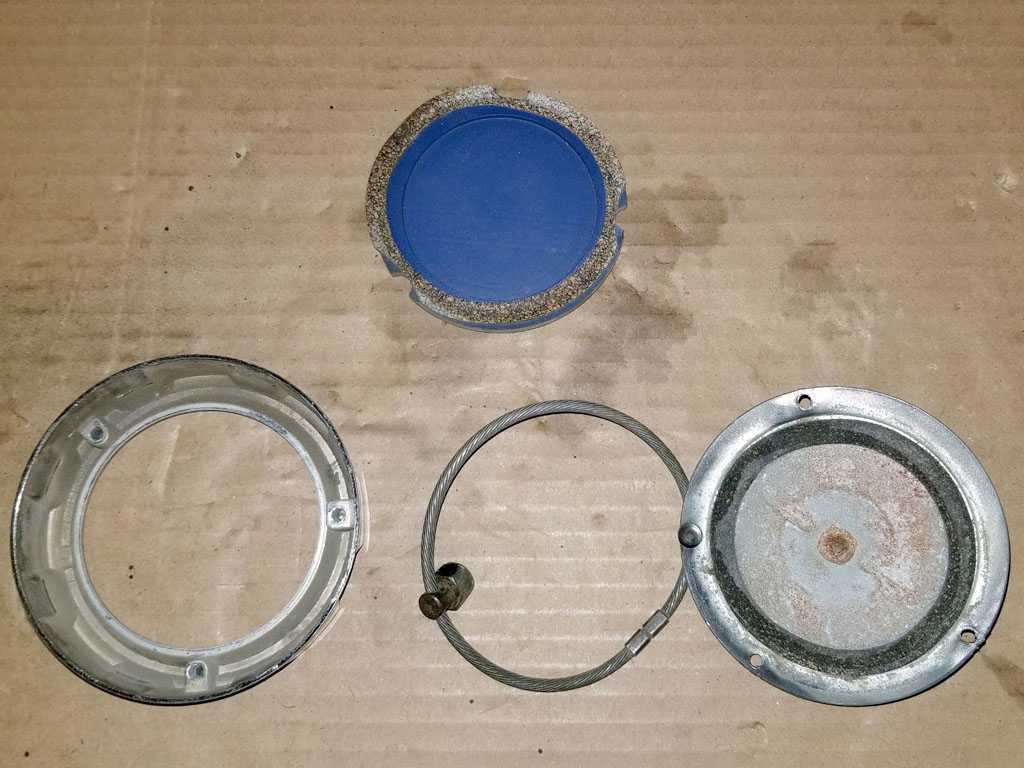

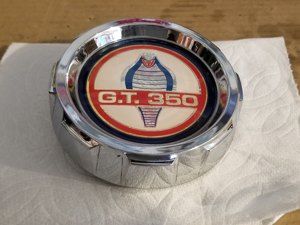

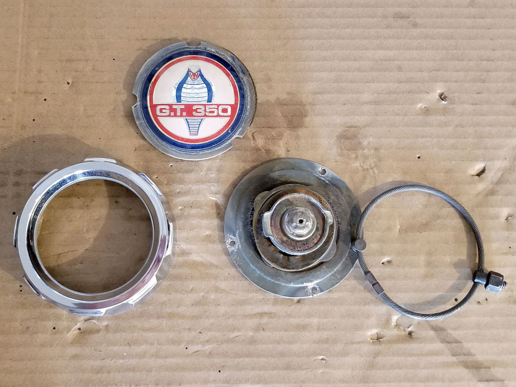

After sitting in a box for many years, I decided to put the original gas cap for 6S1757 back on the car. But first it needed to be cleaned up...the gasket was shot, back had gunk and some corrosion, oxidation, etc. Well, pretty soon things went sideways and the cap was apart. Posting these pics in case anyone is interested in seeing what one looks like taken apart.
All-in-all turned out pretty well I think. One mistake was to pry out the rivets which chewed up the back plate a little trying to wedge them up, used some JB Weld to clean up the marks. If I did this again I would probably just use a dremel tool and grind the rivets off.

What size and type rivet did you use?
Did you make your own cork gaskets?

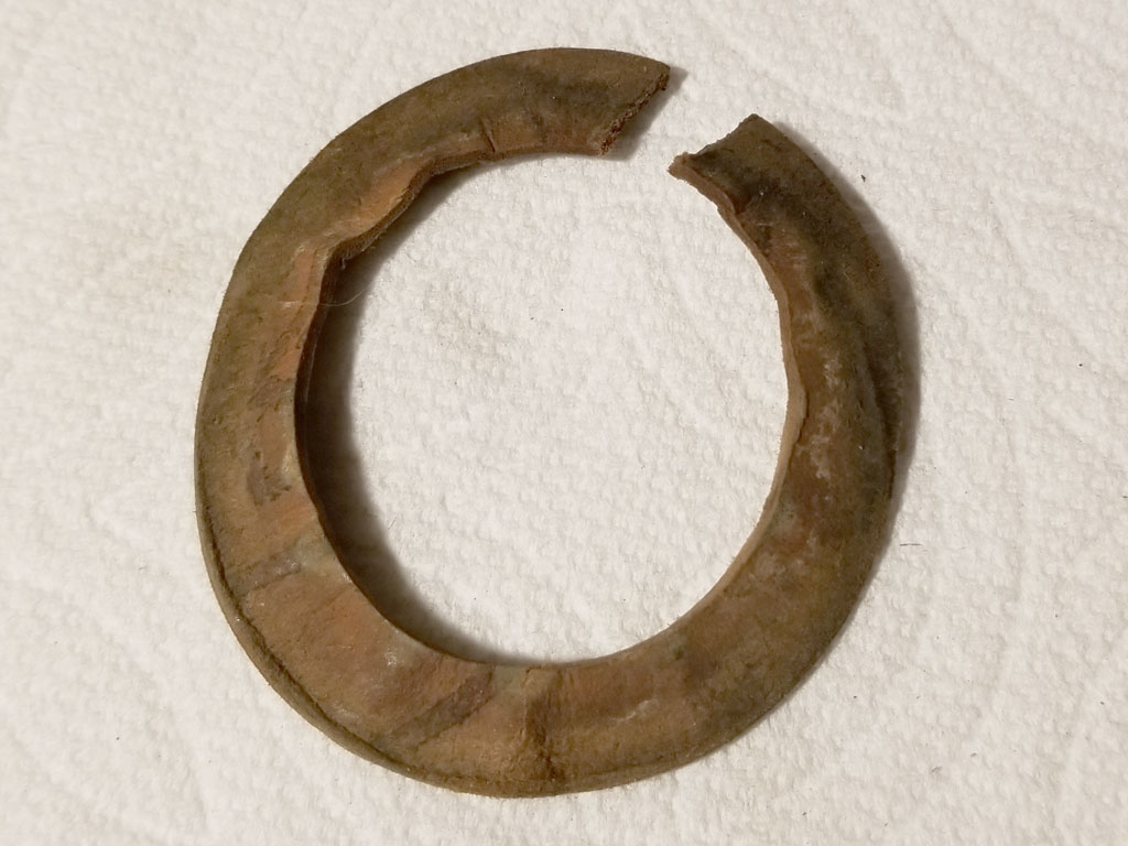

I thought the original seal to the filler neck was a fiber or leather material?  I think the cork one will tear easily.
MCA/SAAC Judge
Yes, the original gasket is a fiber material, mine was toast, badly distorted and likely wouldn't seal worth beans. The different Mustang pasts vendors sell a rubber replacement gasket but I decided to make my own using 1/16" rubberized cork. I was also concerned it would tear but it held up better than expected. Had to stretch it a fair amount to get it over the nozzle but no problem, slipped into place easily. We'll see how it holds up, if there are any issues I'll go with one of the rubber replacements.
Rivets are drive screws, total length 0.40", shaft diameter a little over 1/8", I assume to drive into a 1/8" hole. Cobra valve covers use the same thing for the wire loom baffles, I think those are slightly larger?
Quote from: CharlesTurner on May 03, 2021, 09:13:25 PM
That is what it appears he had when he started (see first picture) but guess he went with the cork on the rebuild

Took a closer look at the original gasket and agree it is thin leather...
