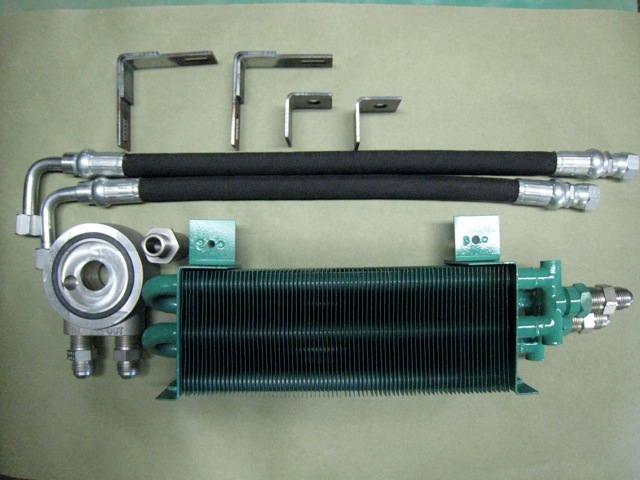

8T03S1425
Here is a repro oil cooler assembly I bought from Jim Cowles, for my '68 GT500 w/AC. It was one of the last heat exchangers, if not the last, he had. I hope that Jesse, or some of his confidants might know where he got them.
I had heard that most reproduction heat exchangers had wavy fins, so I was happy to see straight fins on the one I got. It bolted right up to the original brackets that were on my car.
Steve

Quote from: 8T03S1425 on July 05, 2021, 09:29:07 PM
Steve
So as not to further confuse the OP and others reading as it pertains to the subject at hand (67) that picture is of a reproduction 68 version. The brackets are different on a 67. The cooler is painted black on a 67 . However the hoses and the oil filter adapter are the same as 67 . FYI the original hoses have molded in date markings and the fittings are slightly different in appearance.
