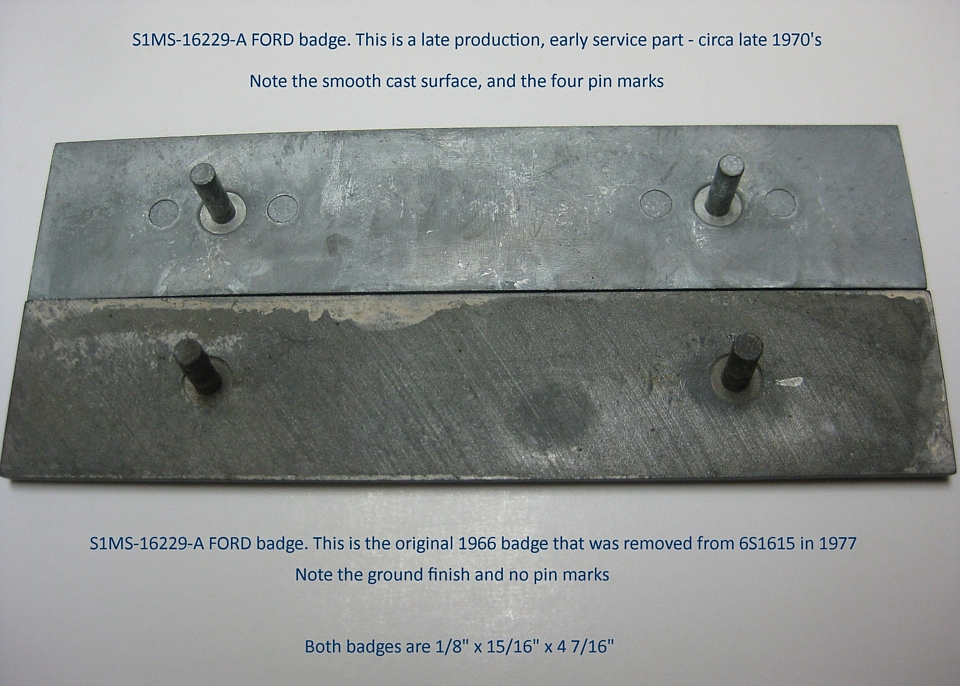

Hi Cory,
I had made this captioned comparison photo of my emblems and posted it on Forum v1, but it was lost into cyberspace along with everything else after the big meltdown.
As stated by others here, the original emblem that I removed from my car in 1977 is the machined version shown at the bottom, and the one on top with the ejection pin marks is a late production / early service part.
Kieth

Kieth ,I would like to point out that there are early service parts and later service parts. Both emblems were in the Ford service system .Through attrition one replaced the other. I have had NOS (early service)versions of the earlier style with the machined backside and NOS versions of the (later service) of the later style with the mold marks. So that there is no misunderstanding NOS in this context is understood as New Old Stock which is a service part and not a part taken off a car in excellent shape unlike what some people like to assign incorrectly.
The "casting flaws" in the OP appear to be corrosion not original flaws.
