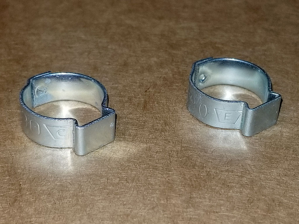

To dive a little deeper into the crimp style clamp...
Don't remember where, but somewhere I've read that OE crimp clamps marked with a "C" logo we assembly line correct for 67 and earlier, and the "E" logo marked clamps 68 and later. Would like to get clarification on that.

Guessing this "C" and "E" relates to the line size;
5/16 = '67 and earlier and
3/8 = '68 and later
Special Ed
Later type 3/8''  use 590 marked

The '.590' on the clamp should indicate the size.

Yes, both clamps are the same size, both marked .590, so don't think it's a fuel line size thing. The "C" clamp shown above was part of an NOS C5AZ-9155-B Rotunda filter kit so should be correct for 5/16" line. Just don't remember where I read it was a 67/68 change.
