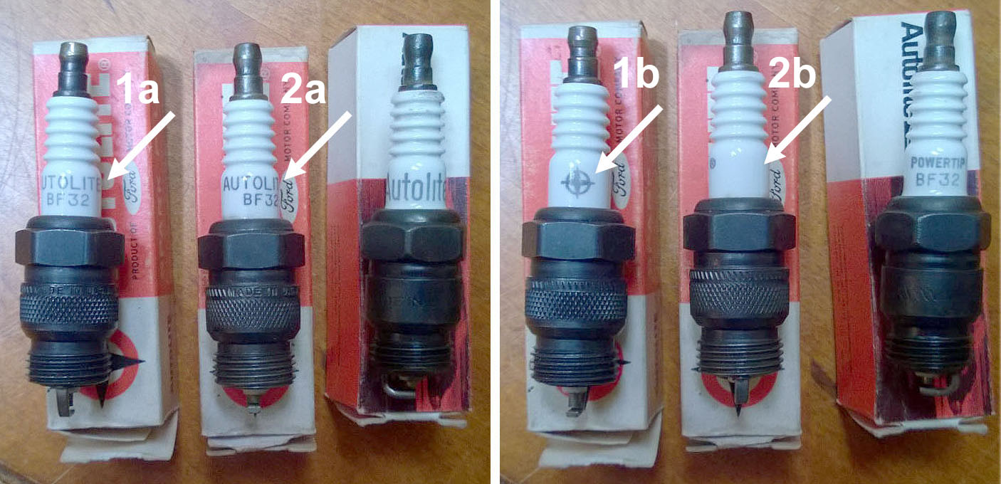

Still trying to figure out how the plugs marked in the panel below fit into all this.  Plug marked 1a and 1b is the famous star logo plug.  Plug marked 2a and 2b has the same style lettering and font except no star logo, these also typically have a shorter electrode like the later Powertip plugs.  It makes sense these are a transitional plug but I've not been able to find any info anywhere on these, only seen very few sets over the years, including 1-2 sets of BF-42s.
IIRC Randy Gillis mentioned he remembered seeing these plugs in the late 66-67 time frame but can't find that discussion so assume it was on forum 1.0.
