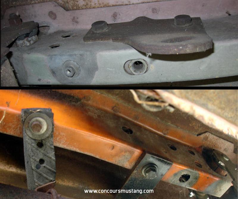

Really neither. That area would have had the rear valance over it by the time the body color was applied. Hung by the screws that attached it from above and not pulled down into the body at the bottom yet. So you would get no overspray or direct spray at the top, little or none from below from body color application but some from the slightly open ends, not traveling much past the ends of the back edge of the quarter panel and some direct spray, often formed sloppy misty oval areas of spray on the rear frame or rear cross member from the body color passing through the back up light openings onto the surface behind depending on how the painter held the spray gun. That area would generally have bare plated metal with some light red oxide and gray primer surfacer from earlier applications to the body prior to the valance being installed and out of the way

Not sure why your using black but at the rear of the car the two colors (factory floor coating and body color don't really meet. Not every surface received a nice full coat of paint to protect it from the elements. One of the reasons a number of panels were galvanized. The spray apparatus for the firewall to rear of the car stopped spraying before it reached the end of the floor so that overspray and paint would not continue and rain down on the cars upper body nor the body that was following. Typical to find examples with no floor color or light overspray on the rear frame rail or the floor and frame just forward of that cross member.

Here are a few unrestored examples showing the factory shadow that the rear valance produced. Typically the rear cross member and rear edge of the floor developed a surface rust over time or worst for some cars depending on how they were used and what part of the country/world they spent their life in

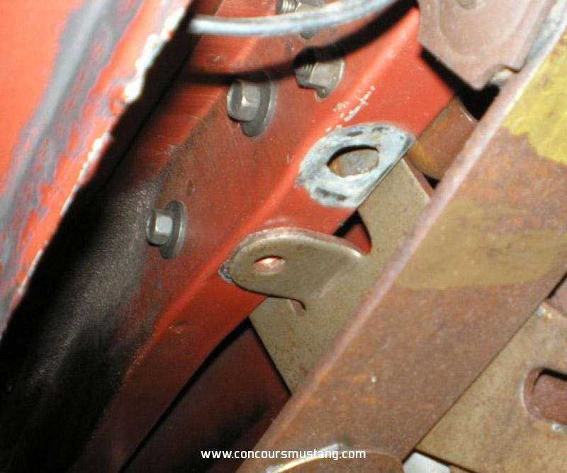

Another example I had handy showing a 69 Dearborn Mustang and the shadows on that cars body
