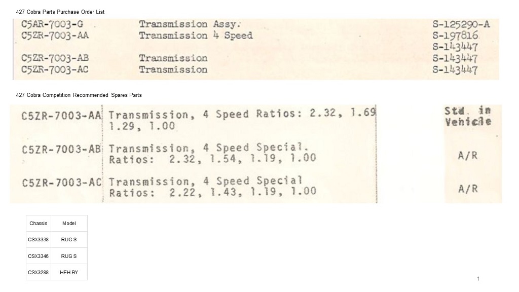

I do very little with 427 Cobra specific parts but I have collected some information over the years. I have the original Shelby American office copy of the purchase order numbers by part they had to buy to complete the street chassis A.C. Cars sent them and some information on recommended spares for competition cars.
Caution: If the 427 Cobra parts lists are no more accurate than the Cobra ones, users should take every part number as a starting point for their own research.
The next page of the purchase order file lists another transmission: C6AR-7003-B. Based on pictures, "1966" cars used a particular transmission and "1967" cars used a different one.
The units listed by chassis number are owner provided assembly tag details.
Dan Case

430dragpack
Quote from: Dan Case on February 03, 2023, 01:55:36 PM
Interesting parts lists.  The C5AR-7003-G is a big input, small output, long tail housing, HEH-R, which was replaced/serviced by the C6AZ-7003-B, which is a big input, big output, long tail housing.   The RUG-S is the big input, big output short tailhousing used in the '67 GT500s.  Not much info/luck yet on the HEH-BY transmission.
