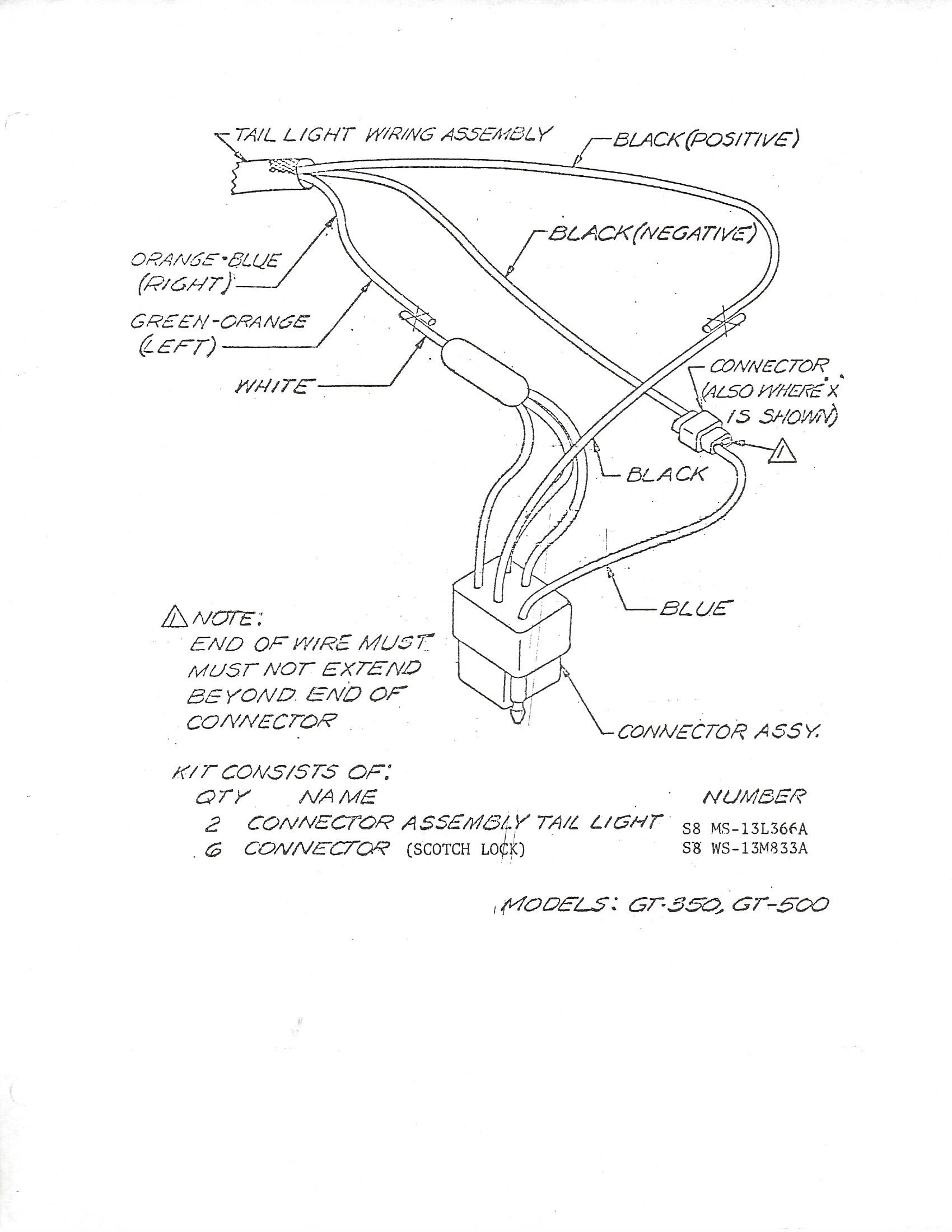

2. Hazard lights flash at the front and the dash when on, but not at the back. Indicators work correctly front and back. My car has the sequencer delete harness (pictured). I can't see it being the flasher as surely they wouldn't work front or rear if that was the issue?

Do you have the sequencer delete wiring diagram?

The sequencer delete wiring diagram I don't have and would love a copy, or advice on where I may be able to get one.

I have these delete wires available and will send them out with these instructions....$35 set plus shipping
