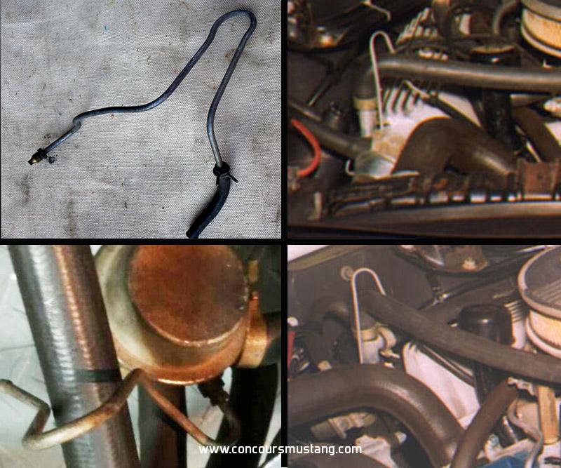

Laying across the upper radiator hose, appears to be a small metal vacuum line.  Anyone know what that is?

Quote from: rhjanes on November 27, 2023, 11:31:22 PM

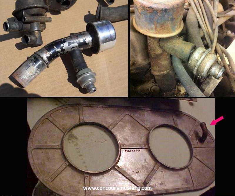

The GT500 with thermactor used a special oil filler tube that had a sideways extended nipple.  A check valve was sandwiched between two hoses that connected to the air cleaner assembly. The short open end of the hose is what you see in the picture . The check valve and other short hose would most likely still be connected to the air cleaner assembly that is out of the picture
That is the vacuum line for the Thermactor valve located basically directly below it in the picture. Tube screws into the threads into its main body of the valve with a brass fitting
Quote from: rhjanes on November 27, 2023, 11:31:22 PMAlso, There is an oil breather cap that is off the rear passenger side valve cover, up at the front of the passenger valve cover.  There also appears to be an open hose there.  Part of the breather?
Not sure where your indicating. No oil breather car on the passenger side valve cover on these cars
At the rear of the passenger side valve cover I see the PCV hose attached to the PCV and the heater hose bend up under the export brace and then down/rearward to the heater core nipple. There is another hose just forward of those two that is the passenger side Thermator hose that attaches to the Thermactor manifold for the passenger side head.
Maybe your seeing the short section of hose that attaches to the breather tube inserted in the front of the intake manifold with the chrome breather cap in place. That hose would have attached to (on this model with the options it has) to a check valve and another short hose that would connect to an elbow on the base of the air cleaner

To make up for being second here are some pictures to better illustrate. Looks like someone in the picture in the original post disconnected the vacuum flex hose and either bent the tube on purpose or leaned on it when doing something else  ::)

Couple of other pictures of air cleaner bottoms and tops
