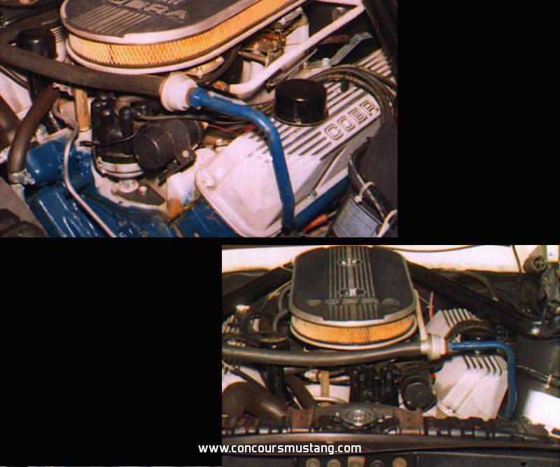

I'm confused. My '67 GT500 (#0962) had a breather cap on the valve cover and had a thermal smog set up. Somewhere in tha archive there is a picture of the engine compartment.
Quote from: 6s2055 on December 01, 2023, 11:15:50 AM
The emission cap was typical on a thermactor equipped car . They are hard to find. A breather cap on the valve cover was for non emission cars. A breather cap on a valve cover of a emission car could happen by factory mistake or past owner substitution. One is more likely then the other . In concours for example a out of the ordinary occurrence like that would require reasonable proof for that specific car . Just because one car has a mistake doesn't mean it is historically proper for every car to be presented with the same mistake .

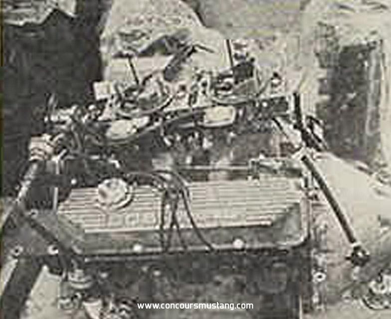

These the ones your thinking of?
Pictures developed/printed June 1967
Would guess that a fair number of us have seen this picture also from a period magazine
6s2055
