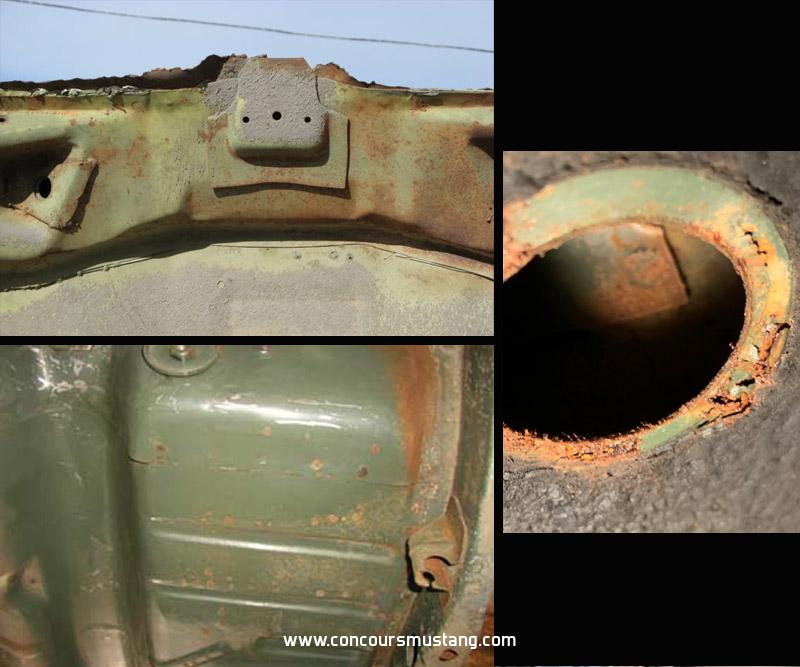

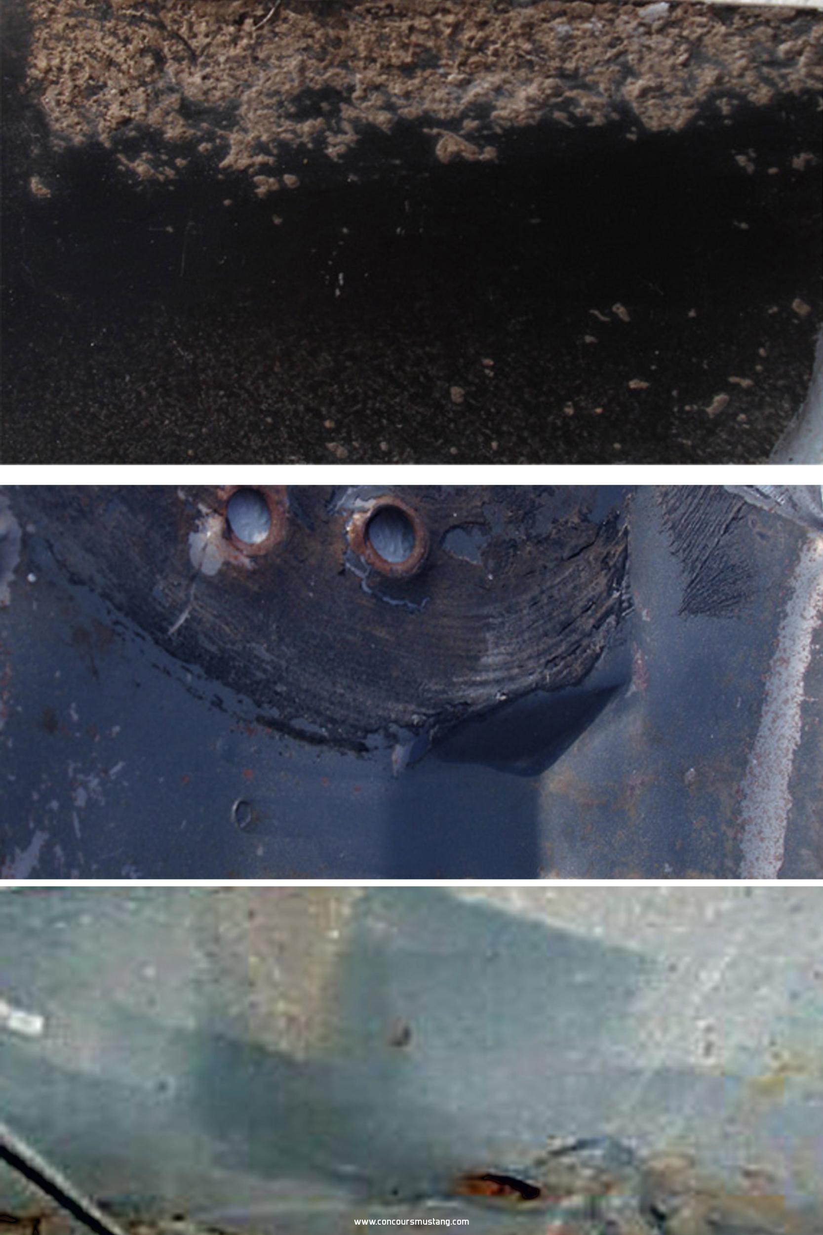

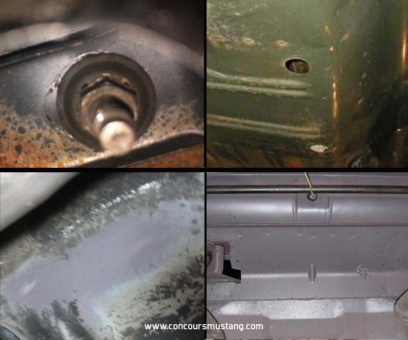

For others with 70 Dearborn build Mustangs and Cougars here are a few pictures that represent the range of finishes typically found
