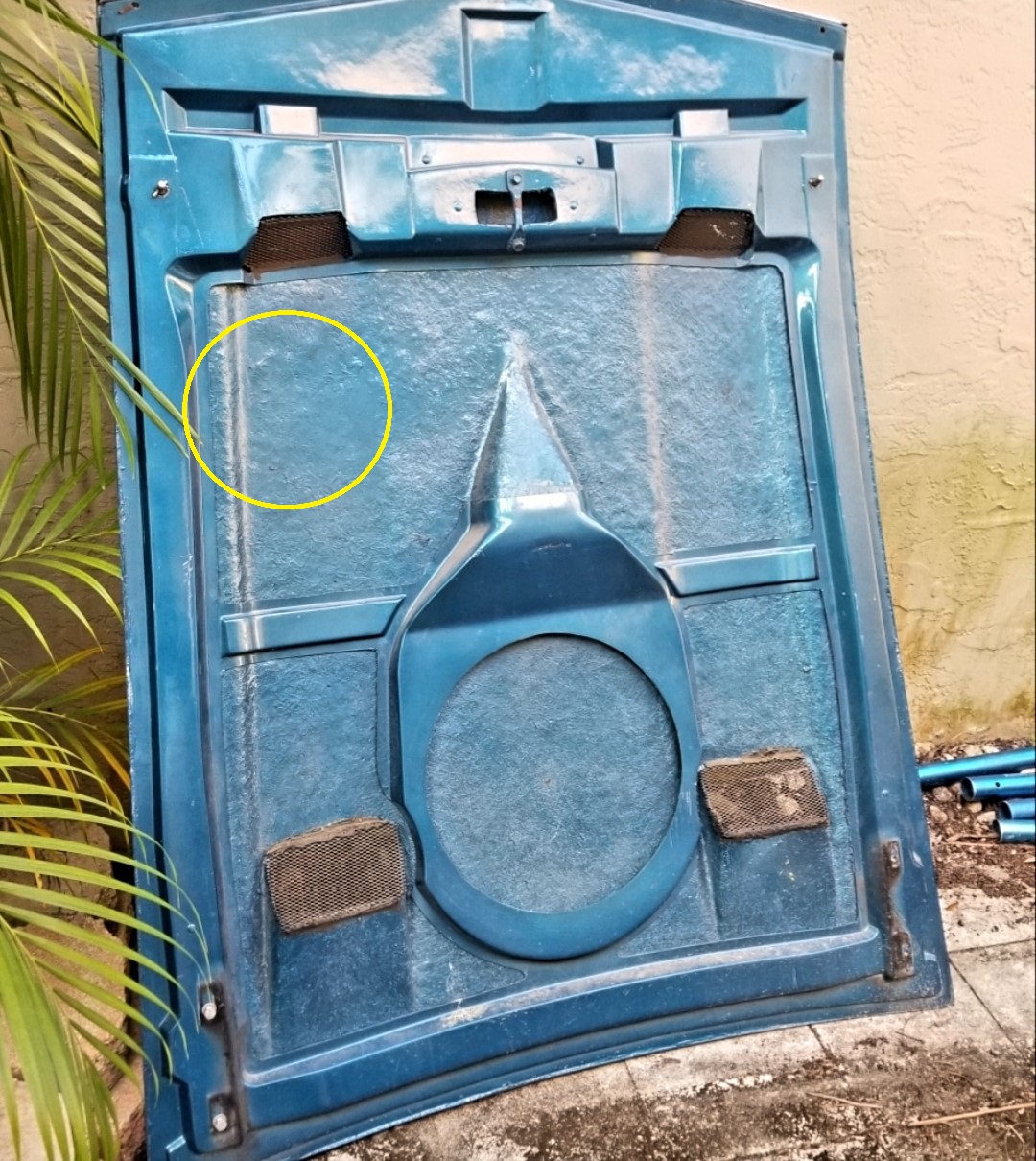

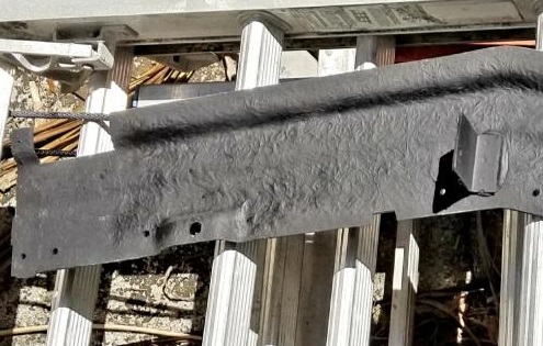

Notice the fibers in the underside of this hood.  Its a reproduction. Tony Branda sells these for $1464.

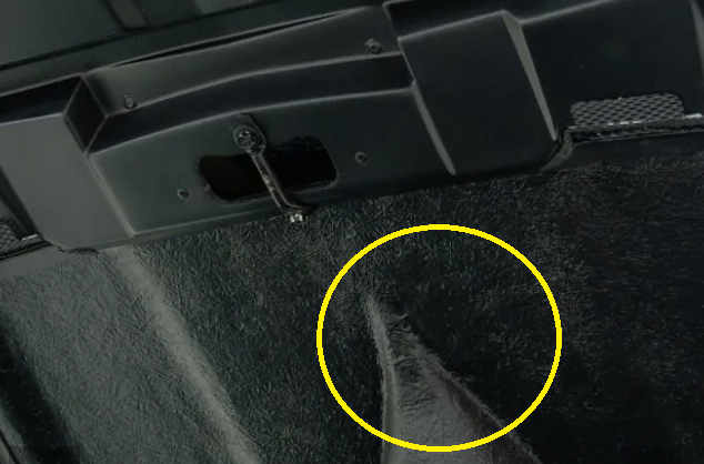

Same here, not even close to the original texture.

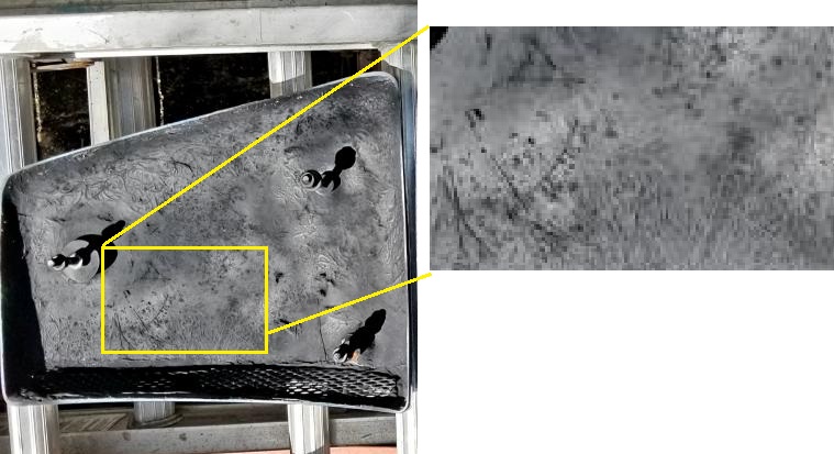

Reproduction lower scoops. Branda price $140

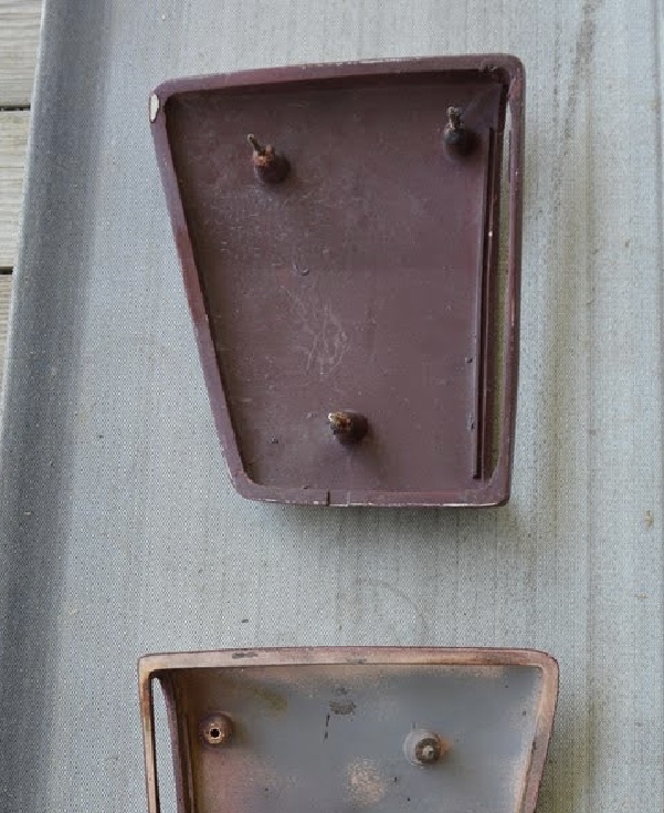

These upper panels were originally made of steel .

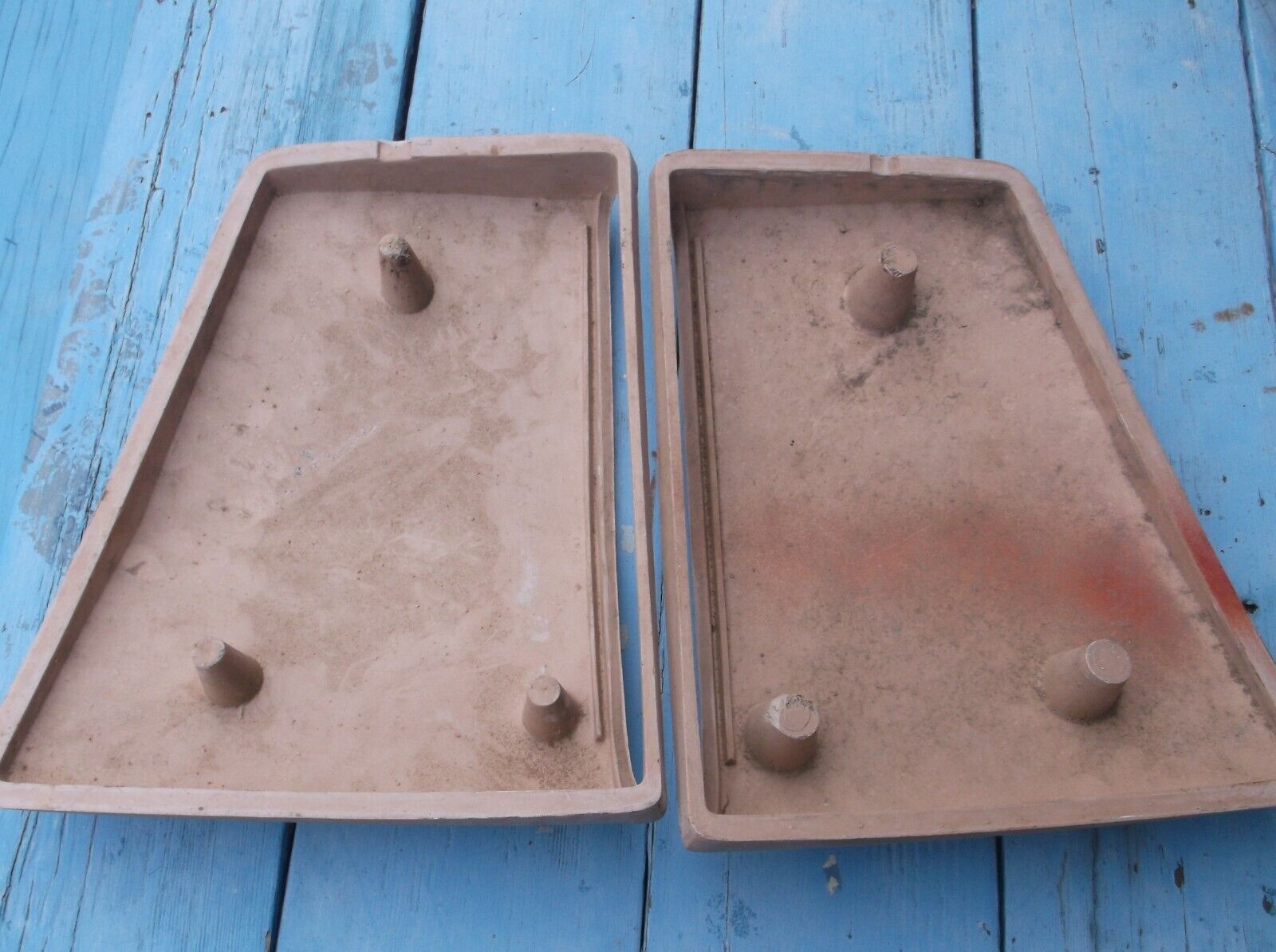

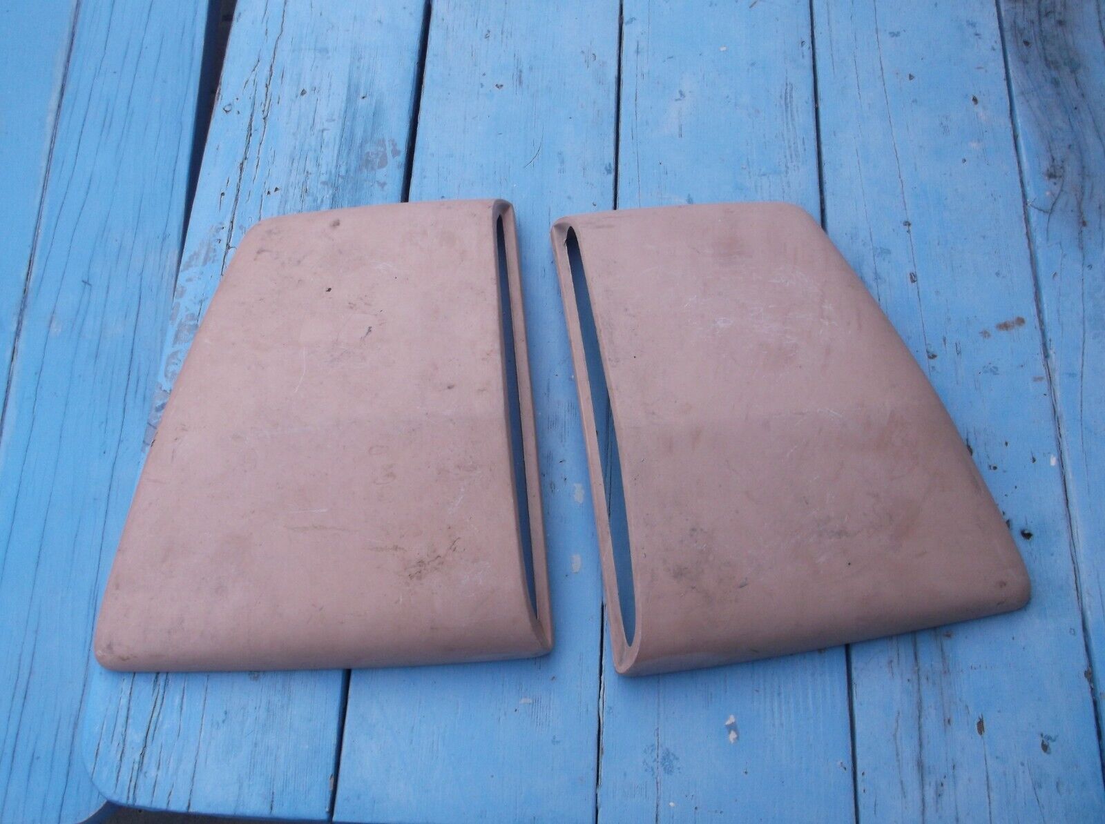

Original scoops from Dave. thanks...
Note pink fiberglass (bottom) and thickness of part compared to reproduction above
