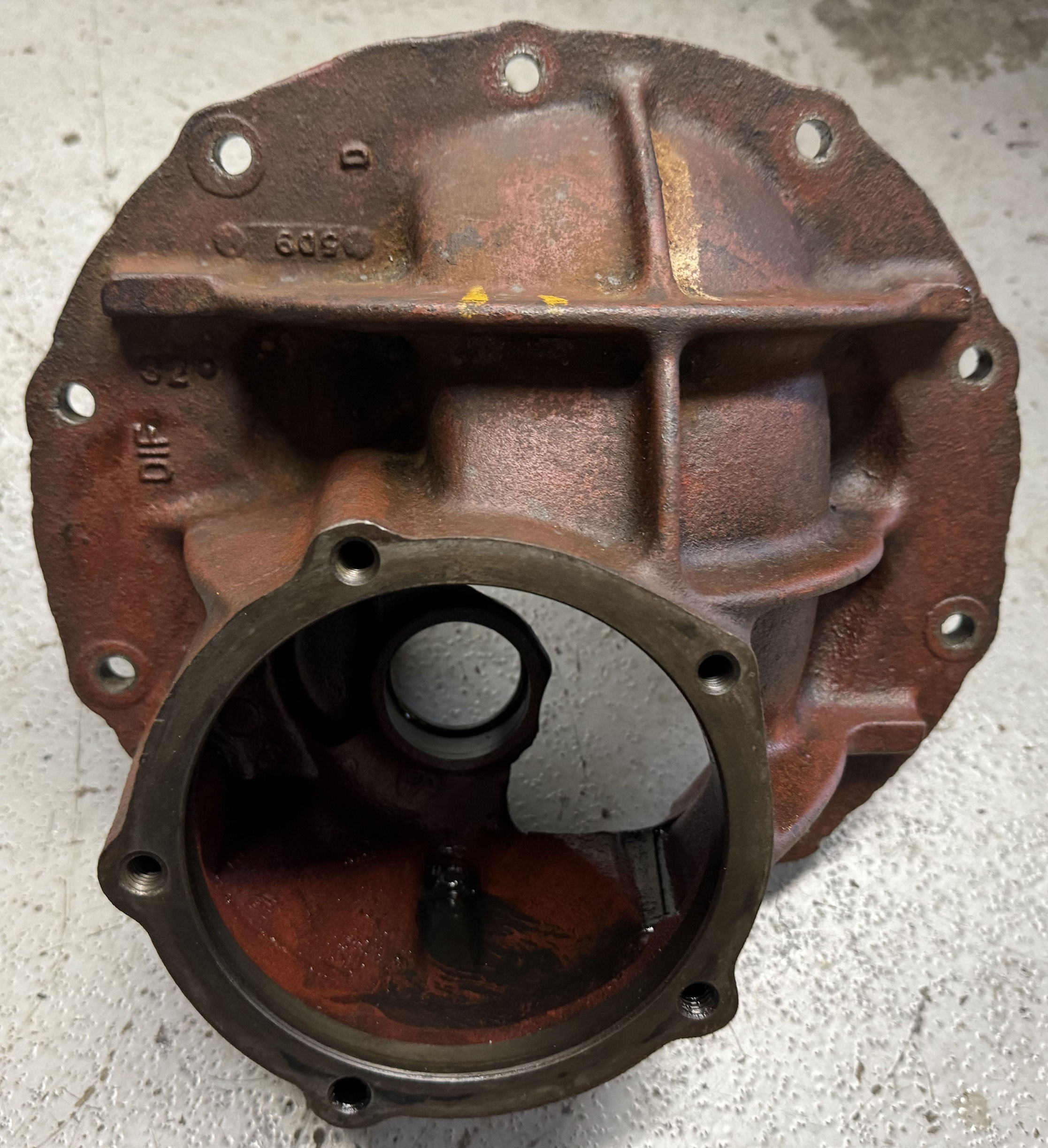

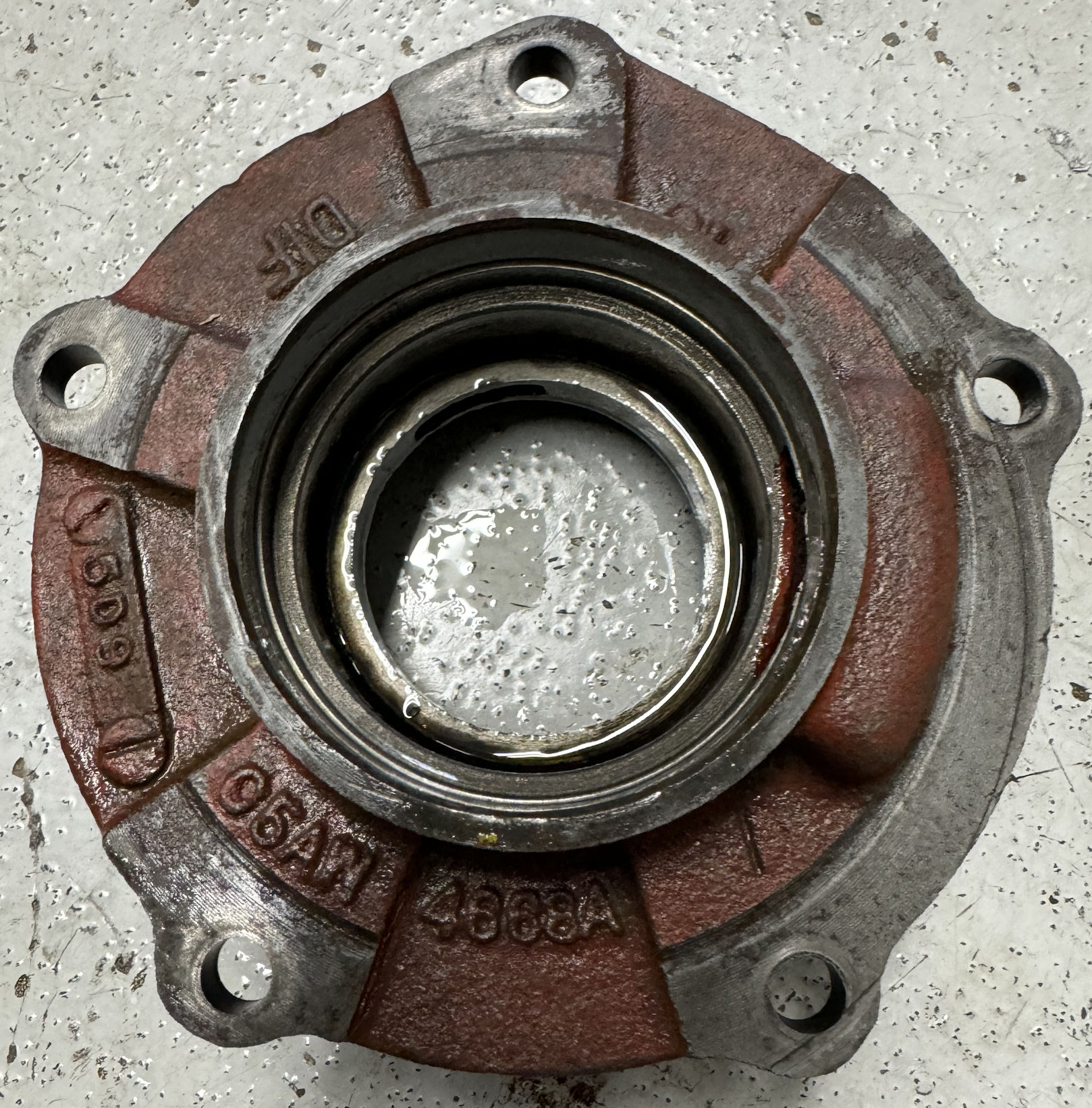

Here is pictures of a C4AW-4025-A, small bearing single rib case, dated 6J1. Notice the small bearing indicator "X", and no fill plug or fill plug provision casting.
430dragpack
Quote from: shelbydoug on August 07, 2024, 12:38:31 PMOK. Now I've seen one. Thanks.
Two... I posted the pictures of the C4AW-C case I have above as well! ;)

Scode67FB
I'm sure there's a website out there somewhere that shows the numbers, but this is what I've personally seen.
single rib case:
C4AW-A small bearing
C4AW-C large bearing
C7AW-E small bearing
C7AW-G large bearing
Nodular Case (w/ or w/o "N" on the front)
C4AW-B large bearing
D0OW-B small bearing
There was also a "C2AW-B" that some claim to be a Nodular, but I don't think that debate has ever been settled.
