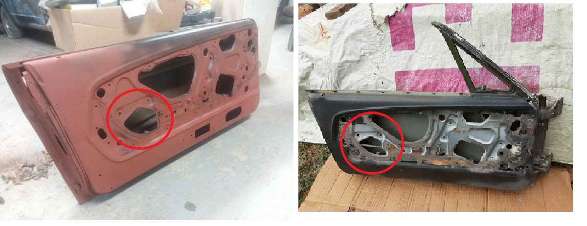

Good next project for your website. Door differences. Or should we post it here so everyone can search for it. I think I have 3 different sets of doors at the moment that I can take pics from.
#7
Here is a 1967 and a 1968 door. The 1967 door is on the left. The 1968 door has a different in this opening
Notice the cutouts circled
They will interchange, but the internal window regulators are also different.
Additionally, a deluxe door will have a cut out for the deluxe interior light at the bottom of the door, the standard door will not
The deluxe door is on the left, the standard type door on the right. Mixing doors may cause issues if you are installing some thing like 68 deluxe, door pulls

Also the hinges are different on early 67 until January they were casted and later then the stamped version came out.
Thanks! Good information
Vent window frames also differ.
