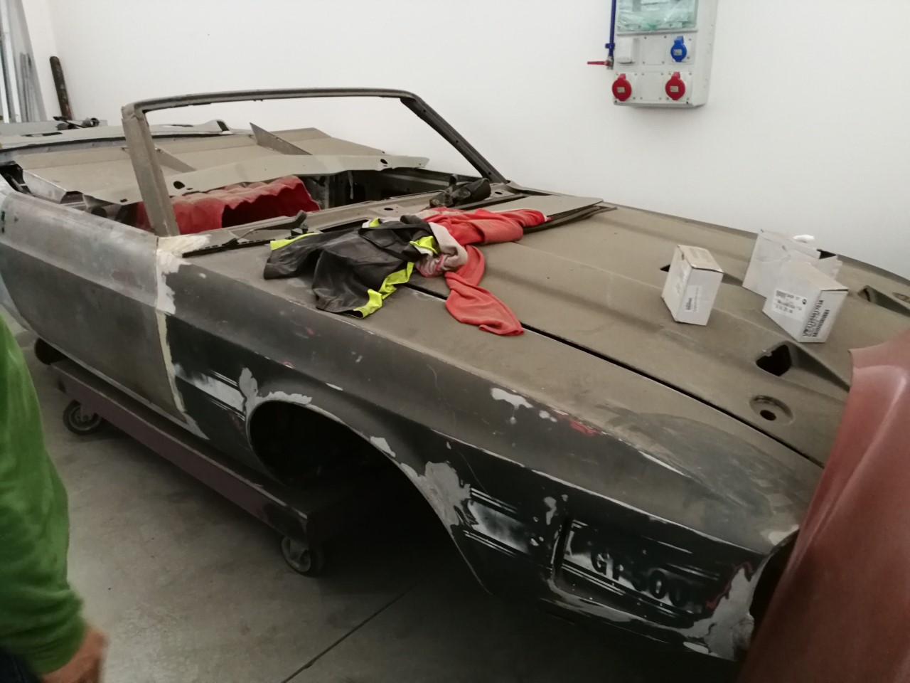

Thank you all for the advice. I will take my time to read them carefully and try to apply the best solution. This is the VIN of my car 9F03R480240
I am attaching some photos
Thank you.

Exactly. The design of the original ribbing resembles the floor of the '67 convertible much more than that of the '69 fastback. That's why I'm confused. Someone have some pics about a 69 convertible without interiors ?

Quote from: Pico88 on September 16, 2024, 03:56:13 PMExactly. The design of the original ribbing resembles the floor of the '67 convertible much more than that of the '69 fastback. That's why I'm confused. Someone have some pics about a 69 convertible without interiors ?
To confuse thing even more there are two 67 floor versions
Here are some pictures of a 69 convertible from the top side.  Just like non-convertible floors if your not looking at all the different parts added/welded to them. Of course its more difficult to see the details from the interior side  :)
Haven't had to use reproduction floors but at one point guys were having to modify the reproductions by adding a different front outer panel with the different webbing.
Hope this helps
