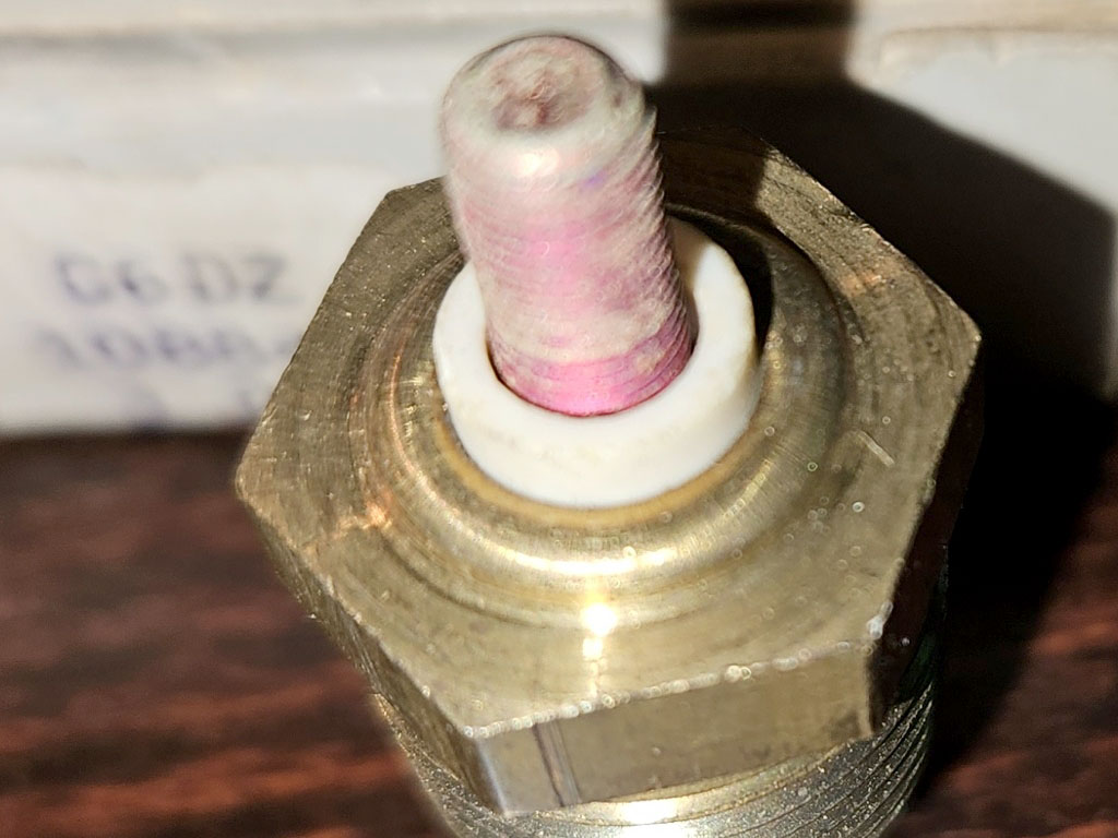

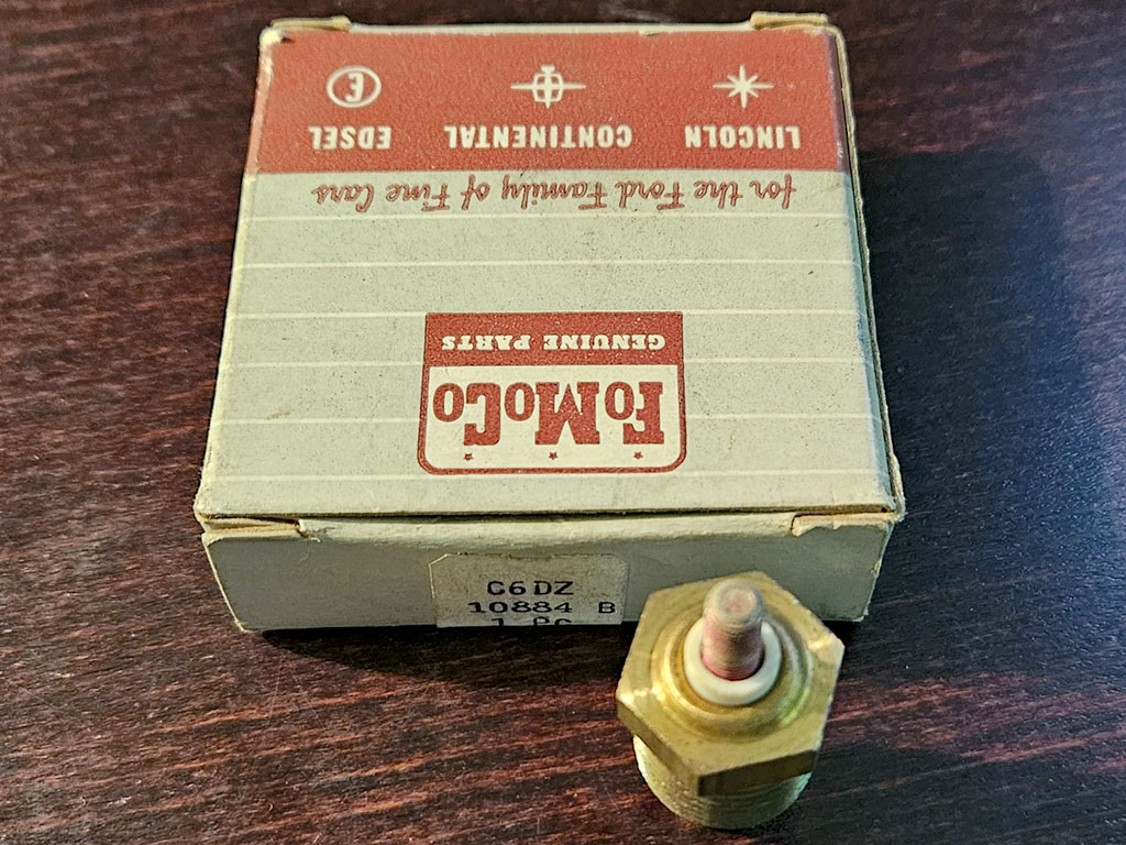

Came across this recently which has me a little confused. I thought the -B senders all have a red insulator while the white insulator was only seen on the -A sender? I have NOS Autolite and Motorcraft -B senders which both have red insulators. At first I thought this was just mis-boxed but it does have the proper 260 temp rating for a -B.
Is it possible the very early -B sender insulators were also white or could the red have completely faded away? Any suggestions for coloring, paint vs dye?
68blk500c
That is very early box.  I'm guessing that under that adhesive C6 label is an earlier part number.  Ford service parts keep us on our toes.
Possibly the red dye you see on the threaded stud is a indicator in the same way the red insulator indicates what it is. Red dye on the threaded stud is not typical on all of the NOS or in the wild senders that I have seen.
Quote from: 68blk500c on September 24, 2024, 02:51:25 PMThat is very early box.  I'm guessing that under that adhesive C6 label is an earlier part number.  Ford service parts keep us on our toes.
Was wondering the same, pulled the label back, no sign of anything under it.
Simple enough to put some red Dykem dye on the insulator so as to make it look as expected.

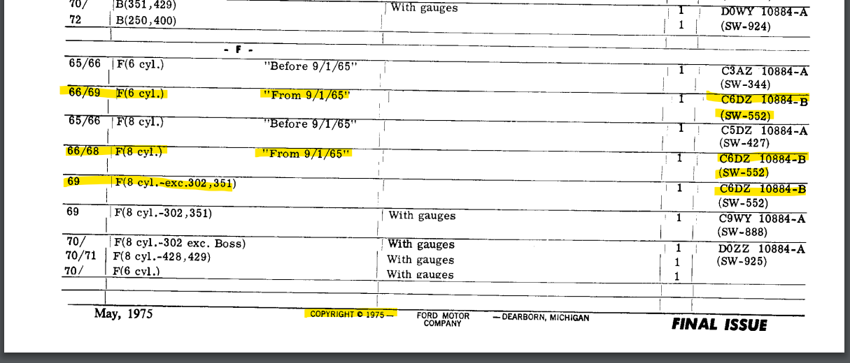

The C6DZ-10884-B sender was mostly used in V8's starting in 1966, it (typically) has a red insulator and 260* temp rating. The C6DZ-10884-A sender was mostly used in 6-cyl but IIRC also some V8's in 1967 and later, it has a white insulator and 250* temp rating. Temp ratings are stamped on one sender nut face. Not near an MPC at the moment but that will have all the details. Bob Mannel's book also has a nice SFB breakdown.
Thanks Brian!
Gets a little more confusing with the info in the 60-68 MPC and Bob Mannel's SBF book, both show the white insulator -A sensor was used on V8's:
1960-68 MPC: (only showing Mustang applications to keep it simple)
C6DZ-10884-A, stamped 250, 3/8"-18 pipe thread, includes white insulator:
- 1966 - 6-cylinder
- 1967-68 - all except 428CJ
C6DZ-10884-B, stamped 260, 3/8"-18 pipe thread, includes red insulator:
- 1966 - 8-cylinder (289, 390, 428)
- 1968 - 428CJ
Bob Mannel's SBF Book: (only lists SBF applications, I'm only showing Mustangs)
C6DZ-10884-A, stamped 250, 3/8"-18 pipe thread, 1-5/8" long, white insulator:
- 1967-69 Mustang (SBF)
C6DZ-10884-B, stamped 260, 3/8"-18 pipe thread, 1-5/8" long, red insulator:
- 1966 Mustang (SBF)
#10
Consider or just be aware that the MPC's often showed not what part was used originally but what part Ford had in the system at the time the MPC was printed, would function as a replacement. Example would be the page from a MPC in reply #8. It shows what Ford had in 1975 almost ten years after the cars were built.
Sometimes same part as original while other times a replacement or substitute. This fact can sometimes explain conflicting data

I see that the unit that Dave shows in the pictures has the cursive Ford type F along with the 260 stamp in it. Is that correct OE 65/66 289 hipo style or what they would've used from SA? Sounds like the main difference is the lack of red on the insulator, correct?
Thanks
6S281, in my family from 1972-1983. Back home January 2017, will not leave again!
Quote from: Karguy on September 28, 2024, 03:52:07 PMI see that the unit that Dave shows in the pictures has the cursive Ford type F along with the 260 stamp in it. Is that correct OE 65/66 289 hipo style or what they would've used from SA? Sounds like the main difference is the lack of red on the insulator, correct?
Thanks
Correct, main difference is the lack of red insulator. FYI that can easily be remedied. I have a strong suspicion that the red dye on the threads was in at least this case taking the place of the red insulator as a identifier.
