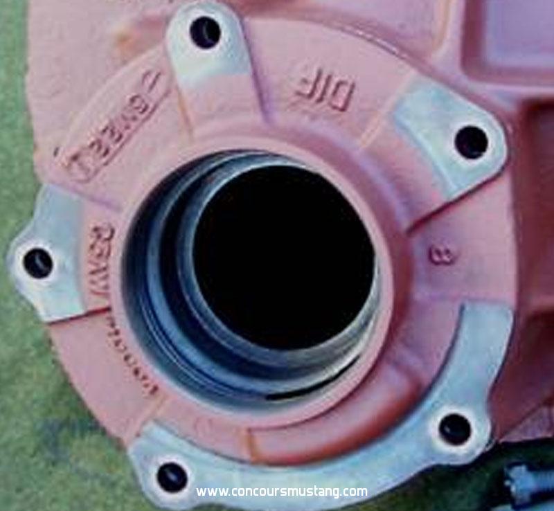

You will find the same single rib design used on early K codes and Shelby's as well as the pinion retainer as shown in the pictures
From a couple of 66 GT350's
Pinion casting number and machined pads

Live and learn. Would there be a way of knowing what Shelby's they would be correct for? Are you saying this rear is correct for all 65 and 66 Shelbys? The '65 I had here was a swap out of a GT350 and was dual ribbed, 28 spline, Detroit locker, 3.89's.
No not stating the third member in the first post is from a Shelby the pictures only showed that the single vertical ribbed third member was used in some performance applications

My understanding it that the C4AW-4025-C could be made/machined for small and large bearings depending on the application.
