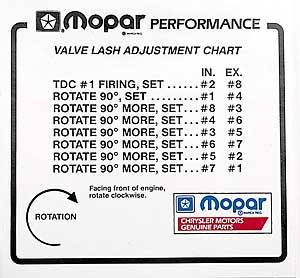

This is what I've always done ^ but now wonder why I never went a step further and made a simple chart like Mopar guys (with correct firing order) and just turn the crank 90 degrees With a breaker bar rather than try to be exact with each bump. https://www.forabodiesonly.com/mopar/attachments/moparvalvecard-jpg.1715048444/

  That method is fine with smaller cams. Using the "factory shop manual" way WILL result in loose valves on aftermarket longer duration , higher lift  cams. I've learned a thing or two in 53 years of building "racin" engines.

This is all pretty good, but perhaps needlessly made complicated. A valve can't get any more 'closed' than when on it's base circle.
The C7FE is a basic Sullivan symmetrical lobe.
I always put 4 paint daubs at each 90 on my damper, but that's not even necessary. Similar to the Mopar gouge posted, two complete engine turns in quarters with both covers off will catch all of the lobes at their nadir wherein they can gapped (remember they can't get any more closed). A couple of minutes!
