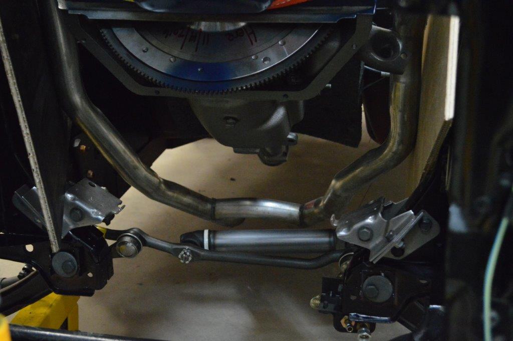

What struck me is how low you got the front end by resting the LCA's on blocks. Does leaving the wheels on, tires on the ground give up too much in the clearance department?
Thanks for everything!

+1 the booster is not in the way of anything but the valve cover is totally in the way of lots of things. I would remove both valve covers.
Quote from: Special Ed on April 03, 2020, 11:49:15 AM
I think I would install booster first with out M/C then remove the tall wide 68 Shelby LH valve cover before engine drop.
Royce Peterson
Also you will have to remove the slave cylinder to get it in there. Or disconnect the idler arm and then disconnect the slave cylinder from the frame bracket so the entire tie rod assembly can be dropped down enough to clear.
The Troll Free Zone
#33
Quote from: Royce Peterson on April 04, 2020, 01:30:39 PM
No you don't...  ;)

I'm going to try the angle deal with the headers. Never even thought that could happen. I bought a set of used Hookers, with all the dimpling done to save time.
I can't admit that Keith is crazier then me so I'm going to have the courage to try it with the transmission attached? Let's see? How much damage can I do in one swipe now?  :o
Keith? Why can't the accessories be attached? The angle is too steep and the alternator will hit the shock towers?

I would leave front sway bar off until engine is dropped for fear of oil pan and dampner hitting it and paint steering gearbox box top black out before engine drop especially on a big block.
The Going Thing
You just have to drop the idler arm from the frame with HOOKER long tube headers ( 6114). No need to do anything more than the two bolts on the idler and turning the wheel slightly. Factory exhaust manifolds are much easier to deal with installation wise and doesn't require the aforementioned step.
Royce Peterson
Good call. I had to remove the sway bar while installing a 428 in a '67 last week because the damper was hitting it.
